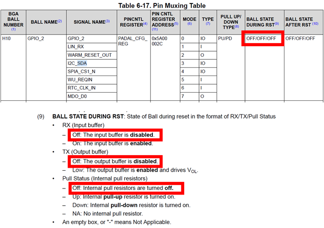

I would like to check the ball state of ARWL6432 during reset.
For example, the pin state of H10 is 'OFF/OFF/OFF' during reset.
I would like to know the exact meaning of 'OFF/OFF/OFF' during reset.
Does 'OFF/OFF/OFF' mean Hi-Z state?
Or does it mean low level state?
If I add external pull-up resistor on H10 pin, can I maintain logic high state of ball H10 during reset?
