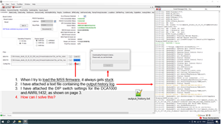

Hi TI,
Hi Wei Zhang,
Thanks for reaching out. You are using the wrong mmWave studio and FW for AWRL1432.
Please download the studio and SDK which has firmware binaries from the below two links.
https://dr-download.ti.com/secure/software-development/ide-configuration-compiler-or-debugger/MD-6g8O78B7OG/04.01.00.06/mmwave_studio_04_01_00_06_win32.exe
Kundan
Hi Wei Zhang,
You can refer to our mmwave studio user guide which is part of mmWave studio folder. Attaching the file path for user guide.
file:///C:/ti/mmwave_studio_04_01_00_06/docs/mmwave_studio_user_guide.pdf
Kundan
