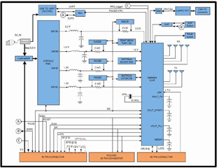

IWR6843ISK: About Current Sensor
Part Number: IWR6843ISK
Other Parts Discussed in Thread: INA226,
The IWR6843ISK is equipped with a current sensor(INA226 : 3.3V and 1.8V and 1.2V and 1.0V).
What is the current sensor information used for?
Is it used to correct something?
  • Hi There,
    The current sensors are essentially placed to measure the currents on respective rails and have the power consumption numbers for different use-cases. Through I2C interfaces these sensors connect to the radar device and the current numbers are read through software.
