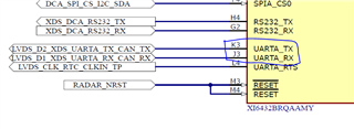

I am trying to setup UART to connect from my AOPEVM to send data to my ESP32, but I am not sure which pins on the board to use and how to set them up in the software? I cant seem to find a proper schematic/diagram that shows the correct mapping of the names of the pins on the board to the names of the pins labeled in the software.

    thankyou and yes could you guide me through the process. I am trying to integrate UARTA so I can stream data to another microcontroller but im not sure how to do so. I have attached the screenshot of the sysconfig page. I am not really sure how the names of the pins in the sysconfig map to the physical pins upon the board. I need some kind of pin to pin connection. Could you also help me navigate how to setup some of the phyisical pins on the board as GPIO? I also have the IWRL6432BOOST and was wondering how I would do the same for that? Thankyou so much,  I have spent alot of time trying to figure this out and couldn't. I really appreciate your help.

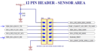

    Could you please let me know why are you not using the RS232 (UARTB) instead? For the IWRL6432AOP EVM, UARTA is not brought out in any headers. On the other hand, RS232 has been brought out to J8 which can be easily accessed. I have pasted the J8 pins and the ones you need to look at below.
    Also, the H4 and G2 are already configured as RS232, so no need of any configuration update.
    The IWRL6432AOP has 101 BGA (Ball Grid Array) balls each one of which are pin-mux'ed with multiple signals. You can take a look at the device pin-muxing table in the data sheet (https://www.ti.com/lit/ds/symlink/iwrl6432aop.pdf) table 6-1 to have a better understanding. If you configure pin J3 and K3 as UARTA, the respective physical pins will be acting as UARTA:
    Similar way you can configure any of the physical pins to the required signals.

    UARTB was already configured in the motion and presence detection OOB, so I thought it was being used for something else. Does this mean I can just use it for my own streaming of data? Do I need to add any other configuration to set the pins or is it fine just as it is for the OOB?
    (Are these the right pins)

    I am also confused on how to figure out how to map the correct pins to the correct signals within the code. For example, within the image you send the connection is xds_dca_rs232_tx on the schematic, but in ccs here are the only options.

    Position of RS232 pins in J8
    That is incorrect. Please correlate the "GND" and "3.3V" pins positions on the board connector to understand what the orientation of the J8 on the board is.

    Mapping signals to the physical balls
    The EVM is developed assuming the most used functionalities and therefore the signal names are very specific. What you should be looking at while changing the functionality of a particular ball is the respective ball number. Sometimes it might be difficult to get the required functionality while the device is still sitting on the EVM. We might need to check the EVM connections in that case to verify if the updated functionality can be supported by the EVM.
