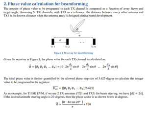

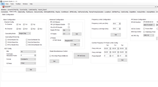

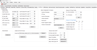

My customer is testing Long range people detection example code with IWR6843ISK code

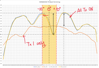

When they turned on all TX and measured Radio characteristics, and they get the result below.
as a result, they observed that the beam forming is not working properly, because the measurement result seem quite broad.
how can they fix this?
