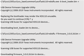

  It shows "Stellaris Device Firmware Upgrade" in device manager in built board. Can you please help to provide the solution to fix this problem?
Should I need to flash xds110 firmware?
If yes, can you please help to provide the flash SOP?

    If not try the following method to load the xds firmware
    1) Open Windows command console in the below folder - C:\ti\ccs1250\ccs\ccs_base\common\uscif\xds110 (ensure that the following path is to your CCS version)
    2) Run the below commands to program the Firmware
               - xdsdfu -b boot_loader.bin -r
               - xdsdfu -f firmware_3.0.0.13.bin -r
    Here is what the process will look like.
    3) Disconnect and re-connect the USB cable to host PC and confirm the XDS110 emulator port displayed in the device manager as shown below
    Let me know if that solves the issues.

      Follow your suggestion to flash XDS110 firmware, the issue is solved.
