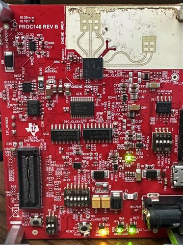

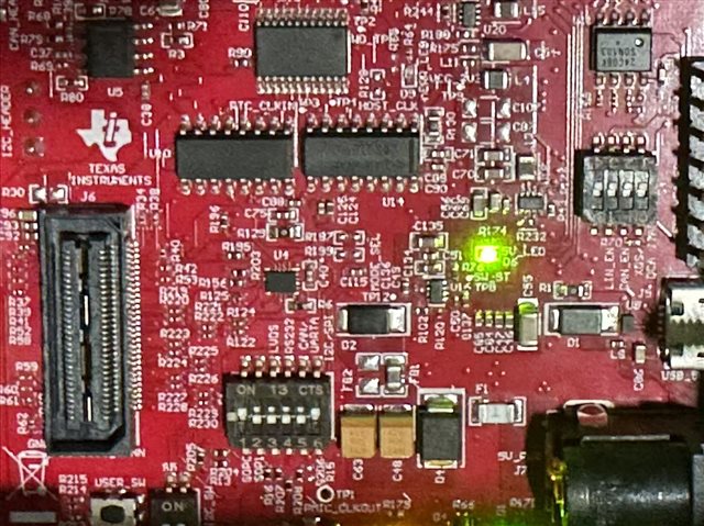

After programming the board successfully, the borad is set to function mode as below.
After toggling the NRST button, and sending the configuration to the board, there is not any data shown in "Industrial Visiualizer" and the following error messages keep popping up:

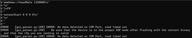

ERROR    [gui_parser.py:189] ERROR: No data detected on COM Port, read timed out
ERROR    [gui_parser.py:190]    Be sure that the device is in the proper SOP mode after flashing with the correct binary, and that the cfg you are sending is valid
Is there any suggestions on this case? Thanks.

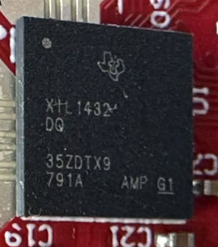

    Is the configuration used a default one for the True Ground Speed demo? Have you also tried running it with the prebuilt binary rather than a project compiled by yourself? I would recommend doing an attempt using the prebuilt binary and premade config.
    Also, can you take a clear picture of the IWRL1432 chip itself? I want to see the engravings on it.

    The below is the photo of the the chip.
    Best wishes

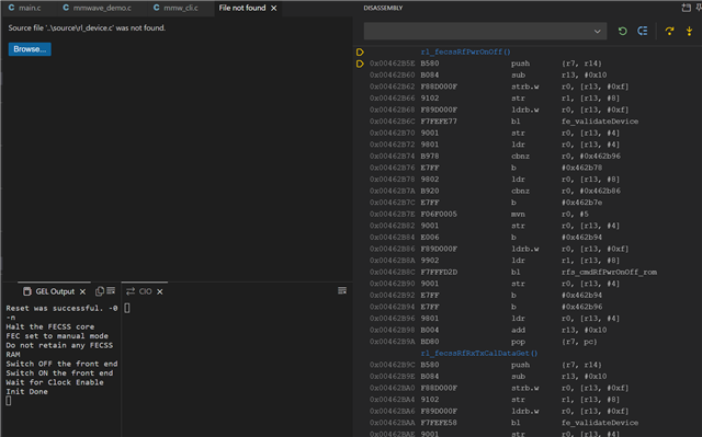

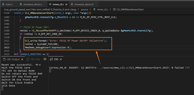

  • I tried to debug the project of "true_ground_speed_xwrL14xx-evm_m4fss0-0_freertos_ti-arm-clang", which was imported from SDK.
    Clean and rebuild the project, pressing the NRST button to reboot the board and pressing F5 to debug the project, then using the visiulaier tools to send the configuration file in radar_toolbox_3_10_00_05. After sending the command 'sensorStart 0 0 0 0\n", the debugger shows the error message 'Cortex_M4_0: ASSERT: 12.865757s: ../source/mmw_cli.c:CLI_MMWaveSensorStart:2413: 0 failed !!!" as below.
    If adding a breakpoint at retVal = rl_fecssRfPwrOnOff(M_DFP_DEVICE_INDEX_0, &gMmwMssMCB.channelCfg);, when stepping into, the CCS 20 shows Source file '..\source\rl_device.c' was not found.
    I checked your silicon and there doesn't seem to be an issue. Just as a test, can you lower the frame rate and number of bursts? frameCfg 32 0 4000 1 100 0. In theory this should not have to be done but I'm curious if the error ends up being different.
    According to the debug information, the application fails at the line : retVal =rl_fecssRfPwrOnOff(M_DFP_DEVICE_INDEX_0, &gMmwMssMCB.channelCfg);,
    The value of retVal is equal to -105, which should be M_DFP_RET_CODE_RFS_PROTOCOL_ERROR.
    Is it possible related to the hardware configurations? As the description in the manual, S1.6 on the device is enabled. I changed the switch to the below, but still fail to run the demo application.
