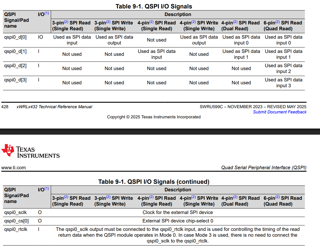

When customer checked AWRL6432, It seems possible to use QSPI in Dual mode.
Does AWRL6432 device also support Dual mode when connecting with QSPI FLASH? They want to use only 2 ports, not 4 ports(D0-D3), if possible.
