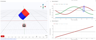

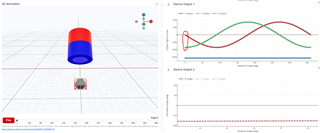

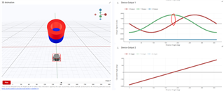

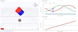

  • Hi Egemen,
    To help determine if the joystick has been tilted up/down/left/right, one option would be to look at the magnetic results of the X and Y-axis, namely the zero-crossings. See the quick TIMSS simulations that I made to demonstrate this below:
    • When pointing upwards(rotation angle 0º/360º) with a 45º tilt, the X-axis observes a magnetic field of about 0mT whereas the Y-axis sees a larger negative magnetic field.
    • When pointing to the left (rotation angle 90º) with a 45º tilt, the X-axis observes a larger negative magnetic field whereas the Y-axis sees a magnetic field of about 0mT.
    • When pointing downwards(rotation angle 180º) with a 45º tilt, the X-axis observes a magnetic field of about 0mT whereas the Y-axis sees a larger positive magnetic field.
    • When pointing to the right (rotation angle 270º) with a 45º tilt, the X-axis observes a larger positive magnetic field whereas the Y-axis sees a magnetic field of about 0mT
    For more specific joystick positioning, you can use the XY angle calculation, shown in the Device Output 2 plots above.
    I have attached the JSON file below for the joystick example that I made so that you can play around with some of the parameters to see how different inputs affect the results. For the below simulation, I have the sensor lined up so that the center of the magnet is centered with the sensing element.

    To determine whether a button press has occurred, I would recommend using the device's calculated magnitude results and checking to see if the magnitude exceeds some set value which would equal a button press.
