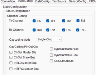

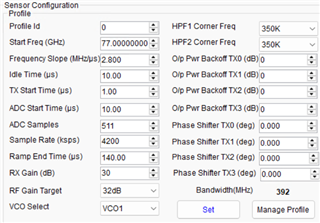

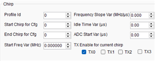

I defined the following configuration in the mmWave studio and I see the configuration works. I see that because the studio is able to generate and show me a dump using PostProc:
In the configuration that I built I tried to get maximum possible SNR for a single Tx operating
Now I converted the configuration into the following configuration file:

profileCfg 0 77 10 10 140 0 0 2.8 1 511 4200 0 0 30
chirpCfg 0 0 0 0 0 0 0 15
