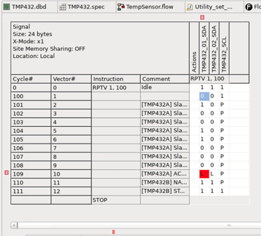

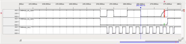

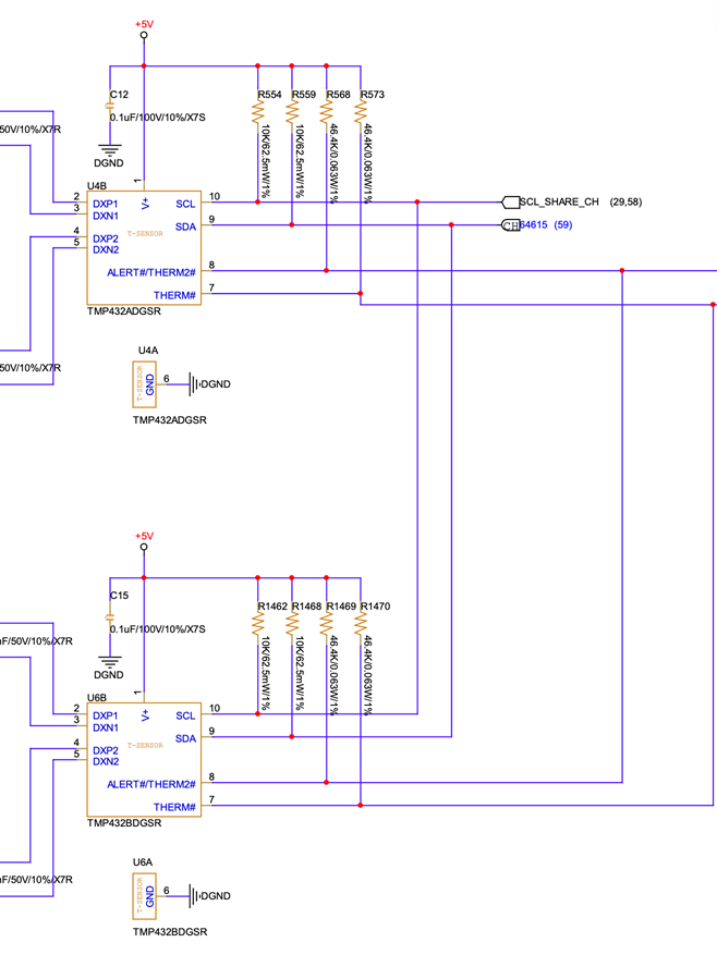

TMP432: can't get the TMP432 any feedback
Part Number: TMP432
hi Sir
i can't get the TMP432 any feedback, could you help it? thanks
  g
  • Hello Chen,
    It seems like you may have too much resistors on your pull up. Too many pull-up resistors on an I2C bus, specifically on the SDA and SCL lines, can cause communication problems due to increased capacitance and decreased rise times. I would recommend sharing the same pull ups for all devices on the same I2C bus. TI has a pull up resistor calculator that you can use: I2C Designer
