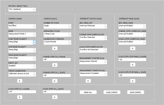

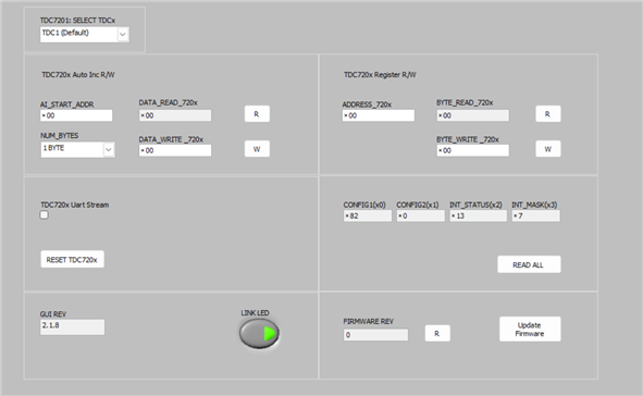

Here is more info about my GUI configuration:

  • Hi Serena,
    It looks like you have everything correct from the hardware persepective.  The problem may be with the format you have for the external frequency.  I believe this field is already in MHz, so you would want to input 10.0 for 10 MHz.  Let me know if that resolves the issue.
