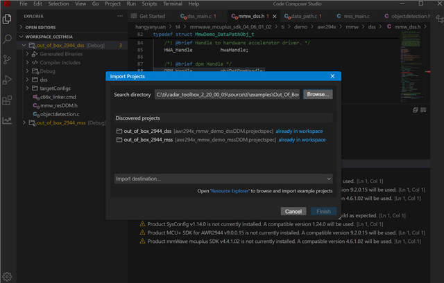

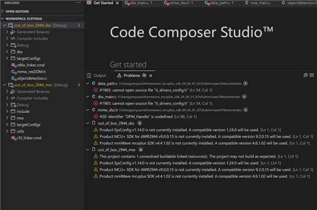

  • Today, we tried to use SDK and radar toolbox in previous version, but there are other different errors, shown in the attached figure. The verision of SDK is ‘MMWAVE-MCUPLUS-SDK Version : 4.6.1.2’ , and the version od radar toolbox is ‘2_20_00_05’.

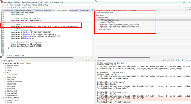

  • Thanks for your reply. According to your reply, we used the projectspec files attached in your reply, and used SDK 4.7.0.1 and CCS 12.8.1. But there are still some errors, shown in attached figure.

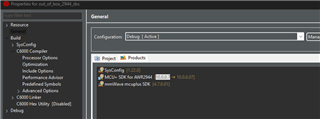

    Could you right click on your project and select properties. From there click general and access the products tab. Make sure that it has all of these proper versions.
    This could be that the newest sysconfig is not being utilized. Let me know.
