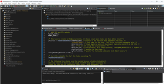

Hii, I am trying to see output data for vital signs monitoring using UniFlash and CCS v12.7
I have imported vital signs demo to ccs from TI's resource explorer and built it
Then flashed vital_signs_xwrl64xx_demo.release.appimage file using uniflash with flash mode
Changed to functional mode
In ccs,created new target configuration,launched it, connected and then loaded C:\Users\Vidhya\workspace_v12\vital_signs_xwrl64xx\Release\vital_signs_xwrl64xx.out
then clicked resume, opened new terminal with my com port updated and utf 8 encoding format,but the terminal is empty.
  • Hi
    If you want to work with CCS, please follow the below instructions
    radar_toolbox_3_10_00_05/software_docs/Debugging_with_older_CCS_versions.html
    You need to flash empty.release.appimage first before connecting to CCS. Once connected, you can download .out created from the CCS project
