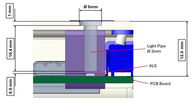

Need clarification on Window calculation for the sensor. Our Sensor is sitting at 10mm from the product casing and for FOV of 45 degree we are getting a window width of 36mm per calculation which we cannot do it in current product.
Can you please suggest on below
1. Can we use a light pipe from the product casing close to the OPT sensor
2. Can you please verify/share the window width needed for 45C FOV and height of 10mm to the casing.
