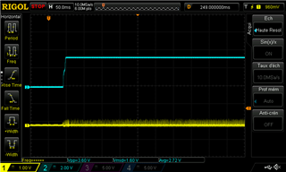

  • Thanks for your reply. Here are the measurements we did, with Vs in blue, Vout in yellow, and no load at all. Vout is measured on C34 after our RC filter as it seems we couldn’t reproduce the issue when the probe was directly on Vout…
    Power on with the glitch for about 350 ms before it shoots back to normal value (the noise on Vs was because of the measurement setup, I fixed it in the next screenshots, the power signal is clean and doesn’t have an impact on the glitch):
    Another glitch where it came back to normal after a longer time (about 2 minutes):
    Here’s when it’s coming back:
    Here’s a zoomed in portion of Vs in AC mode (it measures at 3.28 V otherwise):

  • Hi Holly,
    Thanks for the reply. It’s still harder to reproduce the issue with the scope’s probe on, but I managed to do it while having R30 and C34 disconnected, which means there’s nothing connected on Vout other than the scope’s probe:
    The signal came back to a normal neutral level after about 30 seconds:
    The same glitch with the scope in “High resolution” acquisition mode:
    It’s still quite easier to reproduce the issue when the scope’s probe is off the Vout pin, and when it’s at the wrong “glitch” level, putting back the probe on Vout makes the signal come back to normal generally after about 5 seconds.
    Regarding measurements on the ADC input with C34 populated, those are the ones I uploaded above on the 4th, which show the same glitch and same levels, only filtered.

  • Hi Holly,
    Thanks for your involvement on this issue!
    1. Here’s a screenshot of the device’s power-on, again with Vs in blue and Vout in yellow, so there’s a total rise time of the power supply of about 7.5 ms.
