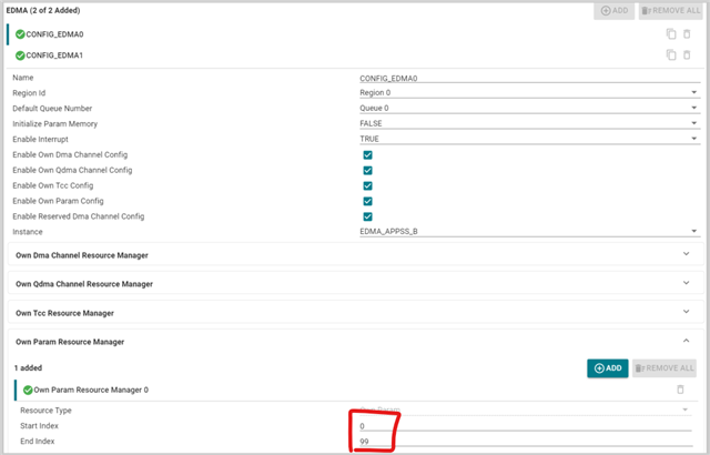

here's our syscfg:

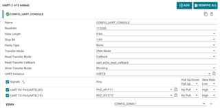

  • Supplementary note: uart receives 71 bytes of data via EDMA every 100ms and send 680 bytes of data to the uart EDMA after receiving the complete data. The entire process is carried out in the edma ISR

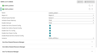

    According to my understanding, when UART EDMA is connected to EDMA_APPSS_A, it has already separated from the EDMA used by hwa in terms of hardware resources. Could you please help confirm and determine whether the EDMA resource conflict is causing the problem which dpc task can not get hwa sem?

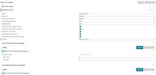

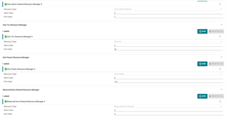

    After a period of investigation,We found that probabilistically, the hwa EDMA interrupt failed to take effect or the uart EDMA interrupt failed to take effect,So we suspect that there is a resource conflict with EDMA configration.
    our AFE suggested distinguishing the param ids of EDMA0/1. Therefore, we made the following configuration:
    hwa EDMA:
    uart EDMA:
    we have cheked hwa edma use max paramID is 65 when Initialization.
    is there any suggest of how to slove this problem or what can I do when do when reproduce this problem(maybe what varble can I read when attach soc)?

  • syscfg is blow:
    uart EDMA
    hwa EDMA
    other edma config is default.
