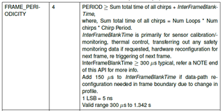

Hi, I would like to know how could I configure the frame period larger than 1 second. In OOB demo, if I configure the frame period larger than 1s, there is an error showing. Where should I modity so I can get a larger frame period?
  • Hi Yifan,
    Maximum frame periodicity that can be configured is 1.342s. You can find this information in section 5.5.3 Sub block 0x0102 – AWR_FRAME_CONF_SET_SB of "C:\ti\mmwave_dfp_01_02_06_03\docs\mmWave-Radar-Interface-Control.pdf". This limit cannot be modified.
