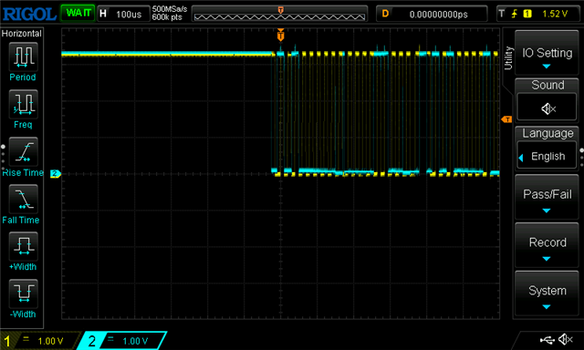

      We have confirmed the operation of FDC1004 under the following conditions,
      but even after starting the measurement, bit 15 (measurement completion
      flag) of the status register does not stand and the measurement operation
      cannot be started.
      //Operation conditions//
      _Power supply: stable 3.3V supply by LP2950 (3.3V during operation has
      been confirmed with a tester)
      _Microcontroller: Arduino Uno (I2C signal has been confirmed via logic
      level converter or direct 3.3V connection)
      _I2C clock: 50kHz
      _Pull-up resistor: 3.3V to 4.7k_ (both SDA/SCL)
      _Between OUT and GND: 0.1_F + 1_F decoupling capacitor installed
      _CIN1: metal electrode connected
      _GND: continuity between microcontroller and FDC1004 GND confirmed with a
      tester
      //What we tried//
      _I2C scanner successfully detected address 0x50 Soft reset, measurement
      setting, and measurement start command were all successfully sent by
      Wire.endTransmission() (return value 0)
      _Tried both single-shot measurement mode and continuous measurement mode
      _The status register value always remains 0, and the measurement
      completion flag is not raised
      _Same results with multiple FDC1004s Result
      //Consultation details//
      As described above, we believe that the power supply, wiring, and I2C
      communication conditions are correct, but we are unable to enter the
      measurement operation.
      In this case, is it correct to assume that there is a possibility of an
      initial defect or defective operation?
      If necessary, we will send you the wiring diagram, test code, logs, etc.
      Thank you in advance.

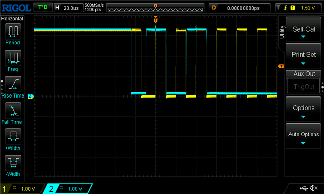

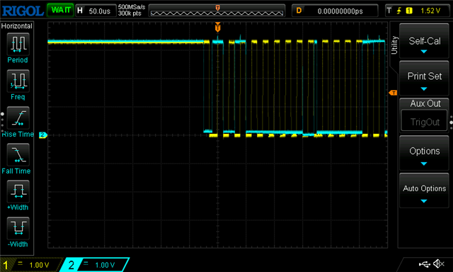

  • Dear Patrick,
    Please refer to below and attached update.
    Waveforms of I2C communication of FDC1004 were acquired using an
    oscilloscope and are attached.
    - The attached images were acquired with time scales of 100_s, 50_s, and
    20_s, respectively.
    - CH1 (yellow) = SCL (SCL pin of FDC1004)
    - CH2 (blue) = SDA (SDA pin of FDC1004)
    Communication waveform is observed, but ACK response from FDC1004 may not
    have been obtained and measurement cannot be started.
    We would appreciate it if you could check if there is any problem with the
    waveform and if the FDC1004 is responding correctly.
    Manuel

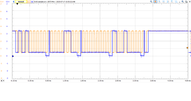

  • Hey Manuel,
    You could be violating a timing specification, you might want to look at various parts of your communication to verify none of the specification in table 5.7 of the datasheet are violated.
    Per my bench tests, it does look like I am able to write 0x0090 to register 0x0C. Below is what my write looked like:
