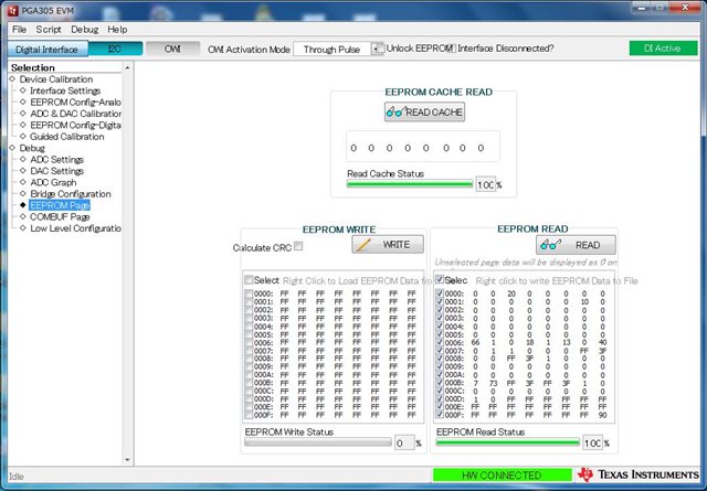

    After soldering the PGA305 and other electronic components onto the board, we perform electrical testing. During this process, we input the hexadecimal value 2760, which corresponds to a DA instruction of approximately 20mA, to verify the current output.
    Below are my answers to your questions.
    • Can you please share the EEPROM values used?
    ⇒ I’ve attached a file named “EEPROM.JPG.”
    • Does this issue occur with one device, or have you seen it across multiple devices? If you've seen it across multiple devices, approximately what percentage of devices are affected?
    ⇒ I have observed variations in output current depending on the production lot of the PGA305. A photo titled “Photo of the production lot of PGA305” is attached for your reference. Using the DAC code “0x2760,” the output current is 20 mA for lot AOSC and 18.5 mA for lot A3VY. These values represent the average of approximately 100 samples for each lot.

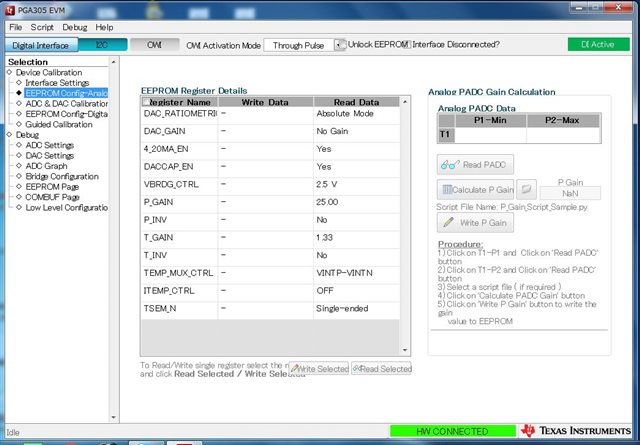

  • Hi Fumihiro,
    Thank you for sharing that information, it's very helpful.
    Would you mind sharing the EEPROM data from this page of the GUI? I apologize, I was not more specific when asking to see your EEPROM. Is the EEPROM read from this page the same across all devices?
    Based on what you shared, it sounds like you are using the DAC Settings page to write outputs to the DAC. Please correct me if I'm wrong.
    When you do this, the value you write does not go through the compensation loop:
    So only the DAC gain is factored into the output current. However, when you are operating the device in current mode, there should be no DAC gain:
    The equation to calculate the current output is as follows:
    So, for a DAC code of 0x2760, you should be expecting a 19.2mA output - that indicates ~4% error for both lot codes.

  • Hi Maggie,
    Thank you for your reply.
    ・Would you mind sharing the EEPROM data from this page of the GUI?
    ⇒I’ve retrieved the EEPROM data again, and I’ll attach it here.
    ・Is the EEPROM read from this page the same across all devices?
    ⇒The written values are the same across all devices.
