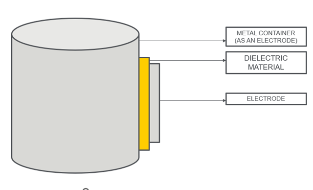

  • John,
    is there a possibility if metal container itself an electrode and top of it an insulator and then again an electrode. it will form a capacitor and that should provide a  change in capacitance along with varying fluid quantity which may be femto farads.
  • Vijay,
    Can you provide a diagram of your proposal?
    John
  • Hi John,
    below is the representation.
  • Vijay,
    For a capacitive sensing system to work, there needs to be some interaction between the liquid to be measured and the electric field created by the capacitive sensing device driving the electrode. Near the electrode, the electric field in the liquid will be strongest, with it weakening as it propagates through the liquid to a point of lower potential, like a ground plane or another electrode of the opposite sign. In other words, the interaction should result in an electric field gradient as it passes through the liquid
    For the system you have drawn, the metal container will result in the same potential at all points around the liquid, so there will no change in potential - and no electric field gradient - thru the liquid.
    One alternative that might work is to use electrodes that are immersed in the liquid, but away from the walls of the tank.
    Please be aware that this will work best if the liquid is non-conductive, like distilled water, as opposed to a conductive liquid like salt water.
