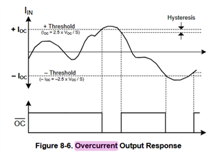

Hi Team,
Configuration: TMCS1133C1A, 3.3V supply, test range -9.2A~115A
Customer ask whether this device will trigger overcurrent when the threshold set to 30A and under -35A condition(Vout=0)?
Thanks in advance.
BRs,
Francis
