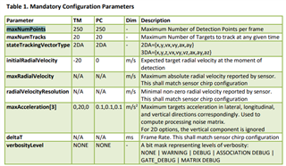

can I run a tracker for 2944 based on this configuration example: Tracker Tuning Guide
If not, how to do that?

    For the the 2944 I would reference this document in the SDK
    "C:\ti\mmwave_mcuplus_sdk_04_07_01_03\mmwave_mcuplus_sdk_04_07_01_03\ti\alg\gtrack\docs\Tracking radar targets with multiple reflection points.pdf"
    It specifies the steps needed to utilize the tracker.

  • No, you dont have to build anything with the HECR demo. This just has an example configuration. The PDF I shared specifies all the steps you need to do. To use the tracker you first need to include the library in your custom build. Then you can add parameters in your .cfg as specified in the pdf shared. Here is the example
    Recommended values for Traffic monitoring (TM) and People counting (PC) use cases are given as an example.
