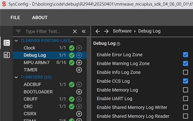

Hi ,
OKay, but I am confused why the C66 sysconfig as following has the enable uart log options?
Bolong
Bolong,
If anyone develops a custom board with AWR2944 or make additional changes in the EVM, they should be able to enable UART logs. Sysconfig is not limited to the users who are utilizing AWR2944 EVM, but it can also be used by people working with their custom boards.
