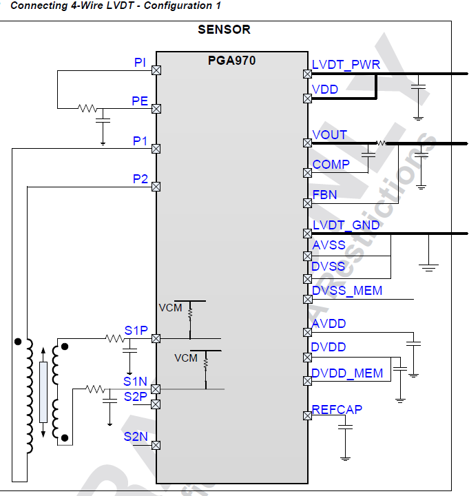

I connected a 4-wire LVDT sensor to the PGA970. However, around the center position, the output becomes non-linear or unstable.
We are using the following configuration to determine the excitation phase:

    How are you calculating the linearity? Is the graph you pictured for ADC1, the DAC, or the entire system?
    Can you please share a schematic or a diagram of how the LVDT sensor is connected to the PGA970?
    Maggie

  • Hi Hasan,

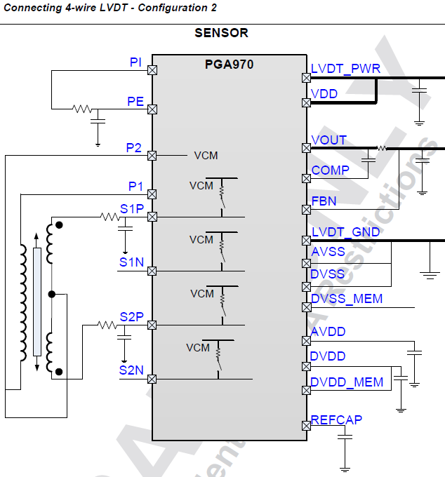

    If are only using one channel for a 4-wire LVDT sensor, then you must connect P2 in between the secondaries (see configuration 2) I don't see that connection in you :
    If you're measuring linearity across the whole system, do you have a compensation algorithm running in the PGA970?
    Maggie
  • Hi Maggie,
    I use the configuration1 that you sent, as I said, I have just S1 and S2 without SM from sensor. I can't connect SM to P2.

  • Hi Hassan,
    I apologize - I misread your earlier message about the configuration.
    Are you using a calibration algorithm in the device? What are your bandpass and lowpass filter settings?
    Maggie

  • Hi Hassan,
    Thanks for the clarification, I understand the difference between the two measurements you took. Let me try to explain the difference in how a 5-wire LVDT and a 4-wire LVDT are measured in the PGA970, based on your configurations.
    PGA970 implements a rectifier-based modulation. When you measure in a 5-wire configuration, you're demodulating each secondary separately. At the end of the demodulation, you use the demodulated outputs in a ratiometric block to get a linear output. Rectifier demodulation is generally used for 5-wire configurations, not 4-wire configurations.
    In your 4-wire setup, you're only using 1 ADC path, which means you can't take advantage of a ratiometric calculation from the secondaries. You can still take a ratiometric measurement with respect to the primary. The resolution of the waveform generator is 14 bits, and you're comparing it to a 24-bit output from the demodulator (as opposed to comparing two 24 bit outputs from both modulators). I'm guessing that is the source of your non-linearity.
    Take these graphs I generated with 3-bit resolution (red) and 5-bit resolution (resolution). The error at the peak of the curve is much more pronounced.
    I know you don't have access to the SM pin in your final design. Is it possible to use both ADCs? You could demodulate S1 and S2 as single-ended signals, as shown in configuration 2 which I shared earlier. That way, your ratiometric measurement is comparing two 24 bit values.

  • Hi Maggie,
    I tested the sensor like configuration2 and with this settings:
    S1_GAIN_SINGLE_END
    S2_GAIN_SINGLE_END
    S1_S2_CONFIG(BIAS_VCM_CTRL_0_0 | VCM_ENABLE);
    and I tested the linearity that is realy worse and more than 3% and same problem in center area.
    in this test, demodulator1,2 did not change big. I mean the maximum value for demodulators is about half in compare with configuration1.
    I know that the 4-wire sensors has problem in center. but I have circuit with AD698 and I tested this sensor with this IC and i works without problem and linearity test even in +-0.5mm in ther center area is less than %0.06.

  • Hi Hassan,
    Are you using the same calibration points as you used for the 5-wire configuration? You will need to use a different compensation algorithm when moving from 5-wire to 4-wire, since you're comparing different quantities. If you're using configuration 1 from above, then it makes sense that you may have issues close to 0. The ADC input will be very small, since the secondary amplitudes are close to canceling each other out, and the phase may be unstable since it is jumping from 0 to 180 rapidly.
    If you're using configuration 2, then my guess is that you're dealing with some ADC error which needs to be calibrated out. I'm not sure what would cause one ADC to shift its output relative to the other.
    If you can take more calibration data close to the center, then you may be able to compensate for the non-linear behavior you're seeing. Unfortunately, I cannot provide more detailed advice for compensating and calibration - that is beyond the scope of support we offer for PGA970.
