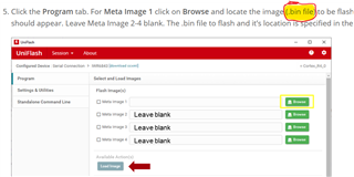

    When you mentioned that a binary file has .appimage extension in relation to radar boards, it cleared my mind and everything fell in place. I guess what screwed me up in the first place is the directions in the document "Using Uniflash With mmWave" which you can see below:
    I would like to mention one minor thing. Even after I re-synced database in Uniflash Settings there was no 6432AOP device or board on the list, only 6432. I used Visualizer to flash the board just to be safe. It also reminds me how to set the switches on the board. Now I am curious, if I select 6432 device or board in Uniflash will it work for 6432AOP board?
