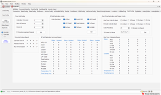

I have a measurement accuracy issue. I want to use compRangeBiasAndRxChanPhase to compensate for range bias and achieve high accuracy. How can I integrate it into a LUA file, or how can I correct it in TI's mmwave studio?

    There is a window in mmwave studio called CalibConfig. When I select “set” after “DataCapture,” a calibration report is generated, but I don't know how to use it in Matalb.

  • Hi
    This information is related to the silicon self calibration. There are more details in this Application Report
    https://www.ti.com/lit/an/spracf4c/spracf4c.pdf
    The compRangeBiasAndRxChanPhase is a different type of calibration. This calibration is required because of the imperfections created by the EVM traces on the EVM. So, these are EVM related calibrations.

    To obtain a very accurate measurement, should I use auto-calibration to calibrate the temperature and Rx gain, as well as compRangeBiasAndRxChanPhase to eliminate imperfections created by the EVM?
    SOUAD
  • Yes, both should be performed.
    The self calibration just needs to be enabled and will be performed by the silicon firmware.
    The compRangeBiasAndRxChanPhase must be performed by the post processing after the ADC data has been captured

    Yes, but when I enabled auto-calibration, I only get a calibration report; I don't know whether the calibration has been performed or not. For compRangeBiasAndRxChanPhase, is there a Matlab script that I can use as a reference to write my own script?
    Souad
  • Yes, the auto-calibration just needs to be enabled. If you don't get an error than it works.
    For compRangeBiasAndRxChanPhase there is C code in an older mmWave SDK but we don't have Matlab code
