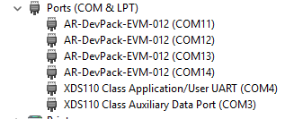

  • COM Ports:
    • Radar XDS110 UART (COM3) and Auxiliary (COM4)
    • DCA1000 FTDI (COM11 to COM14)

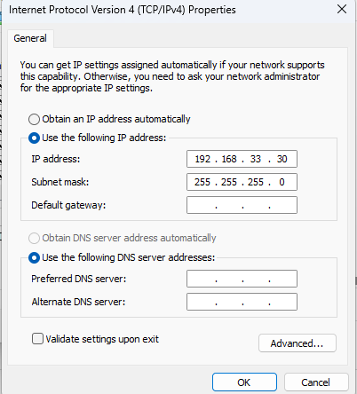

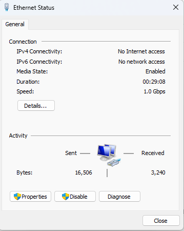

  • USB + Ethernet connected, static IP configured (1 Gbps verified)

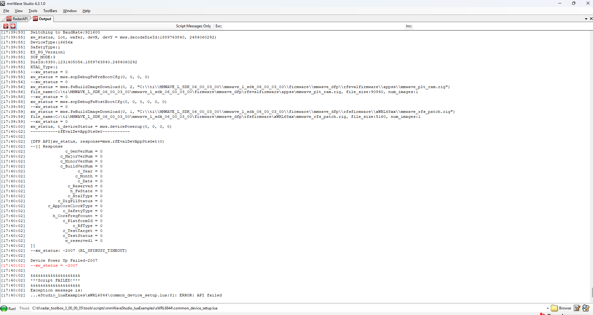

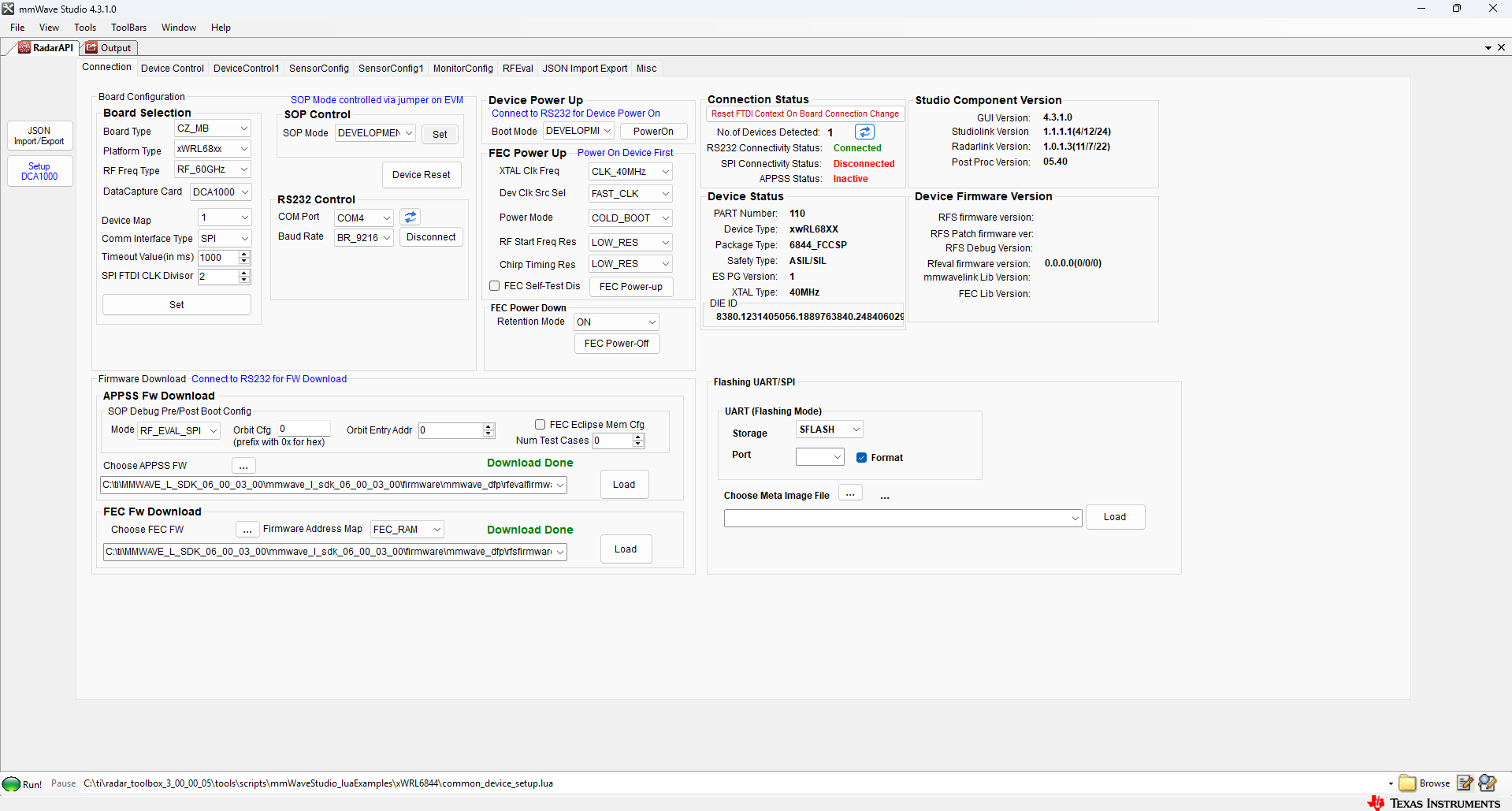

Running the script common_device_setup.lua fails during the Device Power Up phase with the following error:
xw_status = -2007 (RL_SPIBUSY_TIMEOUT)
Device Power Up Failed-2007
  • SPI Connectivity: X Disconnected
  • APSS Status:  ??? Inactive
  • FTDI and RS232: Connected
From the logs, it seems the board hangs during SPI-based reset.

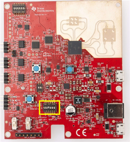

  • Verified DIP switch configuration on both boards (see attached photos)
  • Confirmed proper SOP mode (Mode 3)

I will attach:
  • Photos of both boards and switch settings
  • Screenshots of mmWave Studio connection window

    [17:40:02]  --xw_status: -2007 (RL_SPIBUSY_TIMEOUT)
    [17:40:02]
    [17:40:02]  Device Power Up Failed-2007
    [17:40:02]  --xw_status = -2007
    [17:40:02]
    [17:40:02]  &&&&&&&&&&&&&&&&&&&&
    [17:40:02]  ***Script FAILED!***
    [17:40:02]  Exception message is:
    [17:40:02]  ...eStudio_luaExamples\xWRL6844\common_device_setup.lua:81: ERROR: API failed
  • Screenshot of COM port configuration in Device Manager
