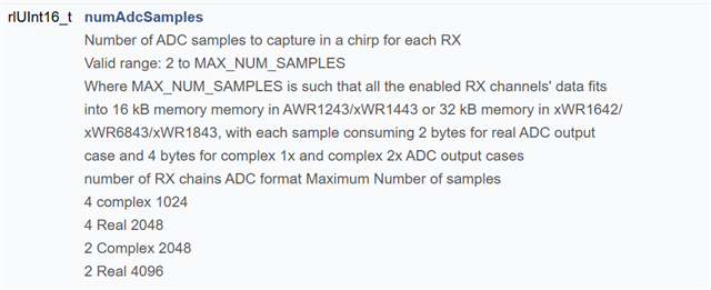

From the Doxygen documentation (file:///C:/ti/mmwave_sdk_03_06_02_00-LTS/packages/ti/control/mmwavelink/docs/doxygen/html/structrl_profile_cfg__t.html), we should be able to program 1024 samples.

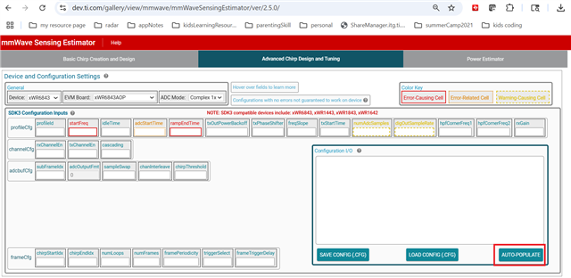

Another concern is the radarCube memory limitation, you can copy/paste your configuration to TI sensing estimator, and click on AUTO_POPULATE button.

I was able to access their configuration file now. Here is what sensing estimator tells us. The ramp time and ADC start time is all too short.
They needs to play with it, and send a valid chirp configuration first. The longer ramp time seems okay.
channelCfg 1 1 0
adcCfg 2 1
adcbufCfg -1 0 1 1 1
profileCfg 0 60 3 3 90 0 0 10 1 1024 12500 0 0 36
chirpCfg 0 0 0 0 0 0 0 1
frameCfg 0 0 16 0 500 1 0

The chirp configuration provided with 1024 samples should work. As mentioned by Zigang, the ramp end time and ADC start time is invalid, so she had suggested bumping up the ramp end time to at least 90 us. This will decrease the maximum velocity, but improve the velocity resolution.

Zigang had shared a modification to the profileCfg command for the DEBUG.cfg you had provided. The front-end commands are given below, but the only change is the rampEndTime.
channelCfg 1 1 0
adcCfg 2 1
Kristien
