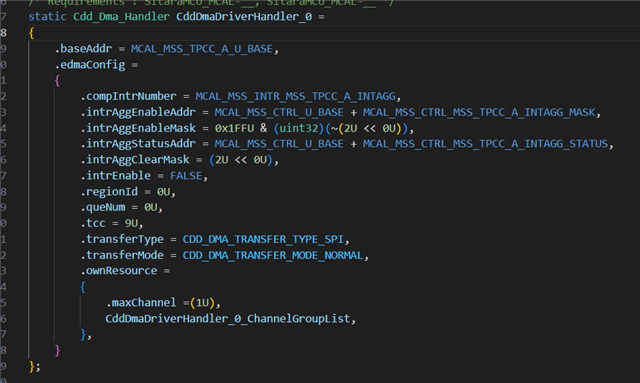

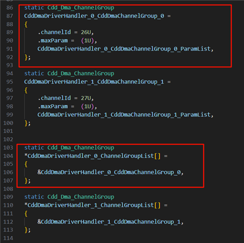

  • I see the sdk and integrated the Cdd_dma module in my project, however, it seems doesn't work for read. The logic analyzer shows no signal at all!
    My configuration is as below.
    The generated code in Mcal is as below, as I didn't configure the ISR for the EDMA, polling read the status and software is structed by ready the status!

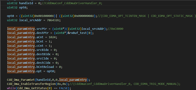

    I have successfully integrated QSPI+EDMA in APP software, however, I migrate to Boot, it doesn't work.
    When called Cdd_Dma_EnableTransferRegion function, ERRDET = 0x00010009, bus error. How to analyze the cause? I don't know what it means for that value and what should I step future?
    Additional information, with logic analyzer the wave is OK, the source address and value are all correct, however, the destination address values are not updated!
