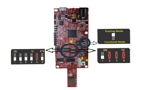

  • Hi sharan, can the switch settings be the reason for this? Can you confirm what should be the switch settings for my project requirement for the IWRL6432AOPEVM board? On one side of the switch it is written ON and other side switch number is written, I expect when the switch is pulled towards ON it is ON and when it is pulled towards the switch numbers it is in OFF condition.
    I have not changed any thing related to QSPI Flash may be the code is not being loaded from the flash on Power Reset or may be we are not storing the image in on board QSPI flash.
    Thanks.
    For flashing or functional mode, there should be a direct switch to toggle between.
  • Hi Sharan, yes I have kept the switch positions as per the above image. Did you go through the project folder I shared ? What could be wrong here if the function does not work after power reboot?
    Let me take a look. Can you try with the default project and check if you can reproduce the behaviour?
    If not, then this is a problem with the changes you have made over the project.
  • Hi Sharan, I have noticed that when I press the Reset switch S2 (blue color bounce switch), I started getting data again, so after each power reboot I had to press(once or twice) the Reset Switch to start getting the data again, I noticed this after flashing the project_name_demo_aop_Release.appimage file. What could be the reason?
