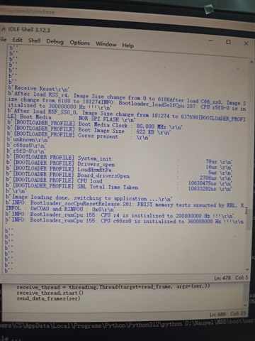

   I encouter a problem that there is a miss of step in process of SBL, shown as below:
Here in the last, there should be a prompt "All done, reset self", but it's not.
Then, I use an another board, it works.
Could you give me some idea of debuging? I don't know what results in this problem.

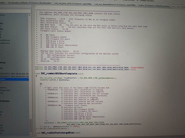

    I'm sure that two boards have identical configurations, further more I have found the reason why the board encounters the problem.
    There is a function which will infinitely loop  if BSS boot fail and the reason why BSS
    The value of bssstatus is 0xD.
    So it is a hardware problem, isn't it?
    How to fix it?
    Could you help me to provide solution of my two problems?
    Zisheng Wang
  • Hello Zisheng,
    It looks like the APLL calibrations have failed in this device for some reason.
    Question: Since when did this error start showing up in this device? And is the error always there or does it pass sometimes and fails some other times.
