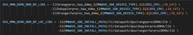

    How do I now cleanly inlcude the created binary in objectdetection.c? Should I modify the makefile in this directory: C:\ti\mmwave_mcuplus_sdk_04_07_00_01\mmwave_mcuplus_sdk_04_07_00_01\ti\datapath\dpc\objectdetection\objdethwaDDMA and then include the headerfile of my library in the .c file itself?
    makefile in the directory that you are pointing to is the used to build the DPC test. Instead, the library and it's path should be included in the application's DSS core makefile - C:\ti\mmwave_mcuplus_sdk_04_07_01_03\mmwave_mcuplus_sdk_04_07_01_03\ti\demo\awr294x\mmw\dss\mmw_dss.mak. You can check how the DPU libs are included and follow the same to include your library.
