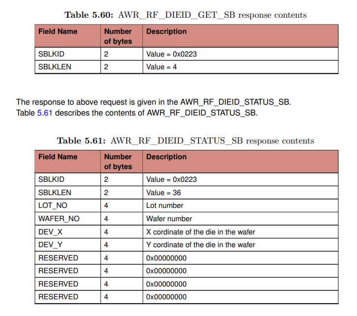

  • Hello Surya,
    In that case I am not sure what you mean by serial number. We track silicon via DIEID LOTID WAFID, what are you looking for when you say "serial number"?
    Pedrhom
  • Hi Pedrhom,
      On the back of the 6843 board there is a S/N and OPN. The serial number (S/N) is a 10 digit ID and not the same as the 7 digit Lot number (LOTID). I was wondering if there is a way to programmatically retrieve that S/N which should be unique whereas LOTID may not be unique. I checked firmware code too but only DIEID is what I could retrieve using mmwave SDK.  If there is no way then I guess the combination of Lot number, Wafer number and Die coordinates in wafer should be unique. Could you confirm this? Thank you!
    Surya
  • Hello Surya,
    I see what you mean. You are looking for the EVM serial ID not the radar silicon, as that is what the S/N is for. I do not believe this S/N is acquirable from the sensor digitally since it is tied to the EVM, not the chip. You can get Lot number, wafer number, and dieid with the same firmware call. In the firmware source rl_sensor.c is the function call "rlGetRfDieId" which returns "RL_RF_DIEID_STATUS_SB". Checking the DFP's ICD (C:\ti\mmwave_dfp_01_02_06_03\docs\mmWave-Radar-Interface-Control.pdf), this returns the values seen below. This is all the information you need for unique identifying logic of sensors.
    Pedrhom
  • Thank you, Pedrhom. I will use the DIEID then as an unique identifier for each 6843.
