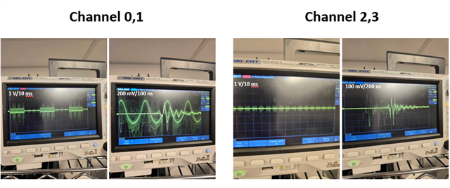

  • Hi John,
    Thank you for the prompt reply. Here are the photos for the channel input. It seemed Channel 0,1 were similar and Channel 3,4 were similar and the amplitudes are pretty smaller than expected and hard to estimate the frequency. Would these signals are okay for the measurements?
    For photos, I put two signals with (1 V/10 ms) and magnified signals with (200 mV/ 100 ns, 100 mV/200 ns) for Channel 0,1 and Channel 3,4.

  • Juyong,
    If I am interpreting the plots correctly (and I may not be), the amplitudes look a little low compared to the data sheet limits of peak Vmin=1.2V & Vmax=1.8V.
    I still think the smaller cap value may be compromising the sensor waveform.
    What is the reason for selecting 100pF? Is it a requirement for your system, or would it be okay to use a different cap value?
    Board parasitics can make it difficult to compute the best value for an application, so one approach is to step thru cap values until you get the frequency and behavior you are looking for.
    Please give this a try if your application permits it.
    John
  • Hi John,
    I also think the amplitude was little lower than I expected (100 - 200 mV), it might be because I connected to computer without power supply. But I wonder why channel 0,1 and 2,3 are showing different signals.
    For capacitance range, 100 pF was used just for checking the board measurement ability for drastic change of capacitance. Our applications will be around 1 nF to 30 nF, so I think it will be fine but still from the analog data, 0.1, 0.2 nF gap should be still well measured. I will try with the thru cap for the measurement!

  • Juyong,
    1. It should be fine to run the part off the laptop/USB, but that connection can result in a lot of power supply noise.
           Just to be sure it is not a factor, it could be worth powering the devicee off an external supply.
    2. The LDC sensor waveform and its frequency depends on the values of L, C and the overall Q of the LC circuit.
      This will determine the frequency range over which it will resonate.
      We don't have much data to offer on the choices for L,C, and Q other than f & Q need to not get too low.
      That may be what is happening for the 22.4nF and 46.3nF caps.
