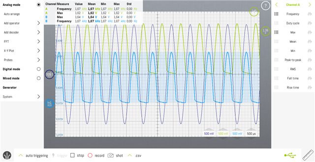

I'm using the LDC1614EVM with a 150 mH coil and 56 nF cap (around 1.7 kHz resonance). I attached to a STM32 controller to read and configure the LDC1614 over jumpers.
The sensor runs in single-channel mode (CH0 only), calibrated IDRIVE is 0x6800, and I use external 40 MHz ref clock.
Even with stable test conditions, I see the measured frequency drifting slowly after ~10 minutes, but sensors frequency didn't shift. Also, the values fluctuate up/down by 100–200 Hz all the time (see attached oscilloscope screenshot and log). I tried the GUI. It behaves similar to my setup.
I tried different rcount and settlecount, but the fluctuation doesn’t go away.
Any ideas what could cause this drift and instability?
Settings are in the uploaded measurement file.
Thanks!

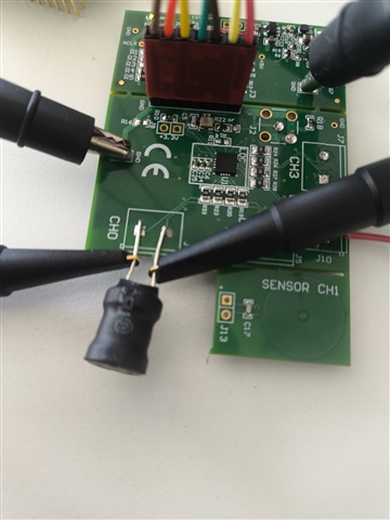

  • Yunus,
    Do you see the same drift if you use the PCB coil instead of the leaded coil shown in your picture?
    How are you measuring the frequency? Is it a direct measurement based on the LDC input waveforms, or is it derived from the device output?
    Does the posted picture always reflect your test setup?
    If so, does removing the probes change the drift (on the device outputs)?
    One trick we have found that helps reduce distortion of the waveform, even with a high impedance probe, is to place a 1k leaded resistor between the probe tip and the PCB test point.
    John
  • Hi John,
    Yes, the picture reflects my current setup. The drift still appears even when I remove the probes, and the output values  (based on LDC1614 data) continue to fluctuate.
    The frequency is derived from the LDC1614 output (DATA register), using the formula provided in the datasheet. I’ve tested both with the 40 MHz external clock and the internal clock (adjusted accordingly in the calculation), but it didn’t significantly change the behavior. The sampling is synchronized using the INTB signal.
    I haven’t yet tested with the PCB coil, because its resonance frequency is outside my range of interest. I’m targeting an oscillation between 1 kHz and 2 kHz.
    Yunus
