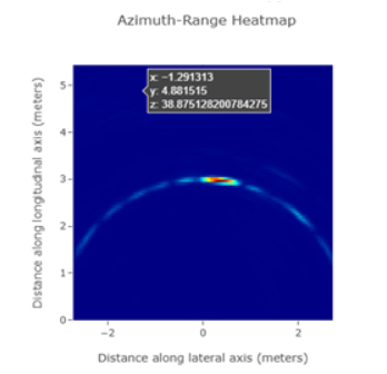

My question is about the AWR2944EVM radar board. I've tested it with the Demo Visualizer and observed quite good azimuth resolution. The Range-Azimuth HeatMap clearly shows an object detected in the correct position, as seen in this image:

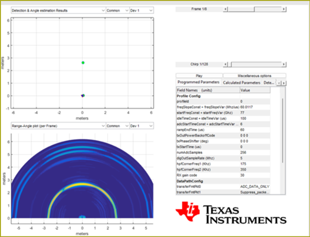

However, I've tried to achieve similar results using mmWave Studio, also connecting the DCA1000 board, but the azimuth resolution is practically nonexistent. The radar doesn't distinguish between two objects at the same distance, even if they are separated by a fairly large angle (around 60 degrees or more). As shown in this other photo , when an object is placed directly in front of the radar, it occupies a semicircle in the Range-Angle Plot of mmWave Studio, instead of yielding a result similar to the first example.

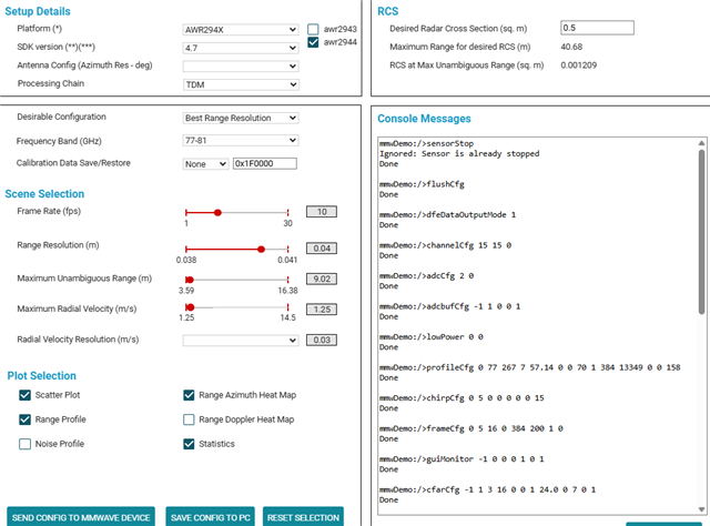

    On the other hand, the configuration I used for the test with the Demo Visualizer was the default configuration, selecting the "Best Range Resolution" option and the 4Rx, 4Tx antenna setting.

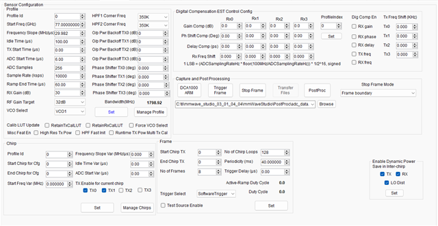

    I am sending you the configuration I used in DemoVisualizer and the configuration I used in mmWave Studio. In mmWave Studio, I only changed a few parameters in these three configuration tabs; I left the others with their default settings. (I only used one profile ID for the chirps.) The test was carried out in an anechoic chamber with a radar target placed in front of the radar.

    You did not send your sensor config tab so I cannot verify that configuration used in the visualizer was properly loaded. Please send that for me. Also I converted the configuration used on the visualizer into a .cfg file for easier usage.

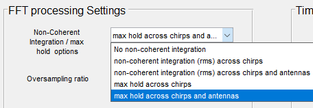

    Also in the meantime in the postproc window can you access the "Miscellaneous options" button and the in the FFT processing window play around with these choices and see if that improves anything

    I consulted someone and it appears that by default postProc assumes that the antenna design is linear. The 2944EVM is slightly different and thus is why you are seeing these issues on studio. I tried seeing if there was a way to fix this but unfortunately this just seems to be a limitation of studio.

    Knowing that PostProc has that limitation, how can I get better results? I'm looking to obtain a heatmap similar to DemoVisualizer's Range-Azimuth Heatmap, but with a greater range (as that heatmap in DemoVisualizer only reaches up to 5 meters on the longitudinal axis).

    The range-azimuth heat map is quite a large load to send for the 2944. It is very likely it is only available to be displayed when the performance settings are very low. This plot will not be viable to display at greater performance than what you have seen it work at. That is why it is primarily grayed out on the visualizer.
