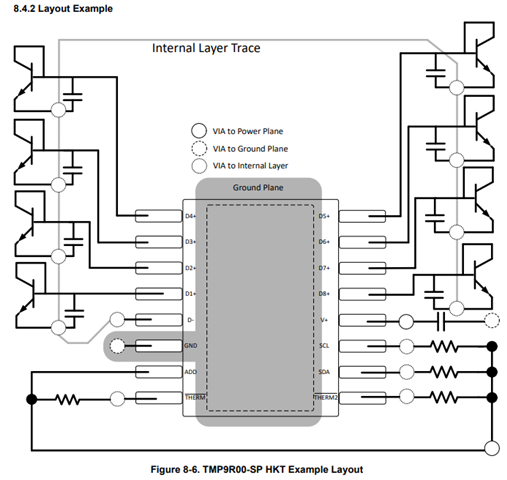

Hello Yusuke,
Can you explain what you mean by land pattern? We have a layout example for TMP9R00-SP within the datasheet page 33.

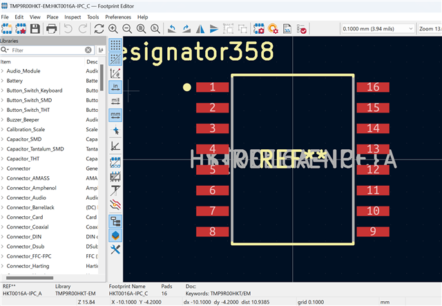

Fancort main customer support email address: cs@fancort.com
CAD footprints are below:
Meredith McKean
