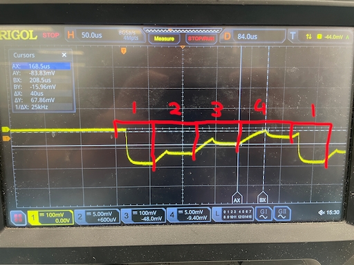

  • Hi Saswat,
    For our application these questions are quite critical so I have a few follow up points
    1) As I understand it, increasing chirp idle time and chirp duration only increases the available transfer time indirectly because it increases the time between chirp available events at the end of ADC sampling. You can increase the available chirp transfer time by only changing ADC_START_TIME_CONST. I have tested this and I have included the basic profile configurations I used (see `enough/not-enough-available-csi-transfer.json`). The only difference between the two is that I increase ADC_START_TIME_CONST from 0->150 for the first chirp, reducing the time between chirp(s) available events, which is enough to cause an issue with the CSI transfer time.

    So if I increase the time between chirp available events (which your suggestion to increase idle time and chirp duration indirectly does), I can increase available CSI transfer time. Given that, I am unclear as to why increasing ADCBUFNUMCHRPPING/ADCBUFNUMCHRPPONG in DSS_REG:ADCBUFCFG4 wouldnt increase available CSI transfer time, given this would directly increase the time between chirp available events?
    2) I have seen ramp end time then chirp idle time quoted in many places, but it seems to be the exact opposite of what is shown in Figure 7, where chirp cycle time is made up of chirp idle time and then ramp end time!

    Basically, I have four profiles, each applied to a chirp, and these four chirps repeat. The first chirp has an idle time of 1000, seocnd 2000, then 3000, then 4000. To help visualise I have also changed the transmit power so its easy to distinguish each chirp. I have attached an image of measurements made with a power detector and scope, and labelled chirp 1-4
    for example:
    • Chirp 4 (the lowest power chirp) has a 4000 ns idle time, which clearly shows up at the start of the chirp, followed by the ramp.
    • Then Chirp 1 (the highest power chirp), with 1000 ns idle time, shows a short gap before ramping up.
    I have also measured the idle time for the other chirps and I can confirm that the order is programmed idle time and THEN ramp time.
    If it really is ramp end time and then chirp idle time, what am I seeing in these measurements?
    3) If it is in fact idle time and then ramp end time, does that mean the actual available transfer time for chirp x is the idle time for chirp x+1 plus the adc sample duration for chirp x+1
    Rex
  • Hello Rex,
    1) You cannot write to that register. There is no means to write to it, since it is a front-end streaming device. This is why I mentioned to increase the chirp idle.
    2) So sorry for the mistype in that answer: you are right it is idle time + ramp time after that. I also cross checked for confirmation on this particular query.
