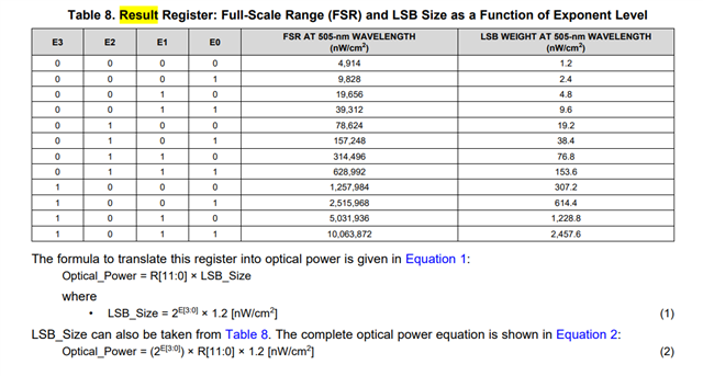

Hi team,
I didn't find 3002 driver. I saw this forum has OPT3001x driver but not see support 3002.
Please advise if it also support 3002.
https://e2e.ti.com/support/sensors-group/sensors/f/sensors-forum/872229/faq-opt300x-family-parts-what-are-the-available-drivers-for-ti-s-family-of-ambient-light-sensors?tisearch=e2e-sitesearch&keymatch=opt3004%252525252520driver
  • Hello Paul,
    The driver you linked above can be used with the 3002 the issue is that the devices listed at that link have human eye response while the 3002 is a wide band device.   The former report in lux while the later report a power value.
    you would need to rewrite the "lux" equation in the driver to follow the equation below:
    Thank you,
