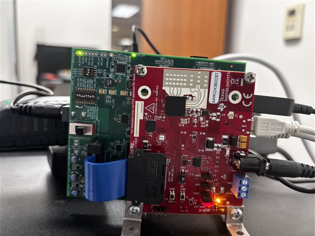

  • Hi
    It looks like the RF board is not responding.
    Is this a new board? has it worked before?
    Can you please send us a picture of the RF board that shows the LEDs which are ON?
    Thank you
    Cesar
  • Yes, this is a new board, last time i collected data on July 18.
  • Hi
    In the picture:
    SOP0 = 0
    SOP1 = 0
    SOP2 = 1
    Can you try the following instead
    SOP0 = 1
    SOP1 = 1
    SOP2 = 0
    Thank you
