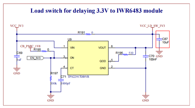

I am studying the design of the AWR6843ISK-ODS and noticed that the VIOIN power supply goes through the U9 switch. However, when I checked the AWR6843 datasheet, I didn’t find any special requirements for the VIOIN input power sequencing.
What is the function of the U9 switch chip? Is it necessary? Looking forward to your reply.

  • Hi Yunlong,
    I apologize for the delay in response. No additional delay is required for 3.3V rail (delay switch can be removed). You can follow the datasheet.
    However, please also consider the errata mentioned below
    During the 3.3-V supply ramp, the GPIO outputs could possibly see a short glitch (rising above the 0 V for a short duration), if the 3.3V supply powers up before the 1.8V supply.
    There is no issue If the GPIOs are not used for any critical signaling (e.g : CAN PHY Enable) where glitches can be tolerated. .
    If GPIOs are used for any critical signaling I would recommend to use a tri-state buffer and/or external pull-ups/pull-downs on it.
