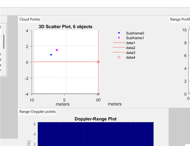

    I was ablet to run the demo on the AOP EVM today.
    I have run the following visualizer and configuration:
    mmw_demo_parking_xyz.exe xwr1843 38 10 4 37 profile_parking_mimo_2d_50m_3d_10m_aop.cfg 1
    Please see my feedback below
    1. Static objects within 5 meters are not being detected, even though they are well within range.
    [Cesar] The snapshot below shows that I was able to detect static objects at a distance larger than 5m. If in your usecase you are not able to detect them, this means that the SNR is not sufficient.
             2, The GUI freezes automatically within 30 seconds of operation and also faced same problem with mmWave_Demo_Visualizer.
    [Cesar] In my testing, I noticed one time that the GUI froze. This did not happen all the time. I am running the GUI for 15min and it still runs. This is caused by matlab high gui processing when there are many detections. One way to improve this is to reduce the number of detected points. There may be ways to optmize the gui code. You would need to check with matlab support forum. Unfortunately the team that developed the GUI is no longer available for support. So, there is no additional support we can provide on this
