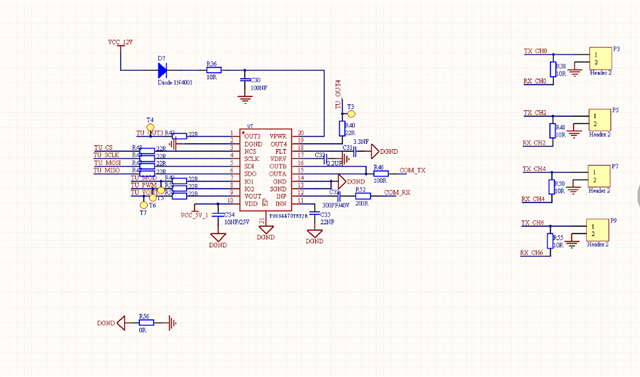

and another question:
That's what my schematic diagram is same. I need to configure it with a center frequency of 200Khz, bandpass, and the maximum receive gain, and then determine the corresponding registers

  • Hi Hui,
    Sorry for the delayed response.
    Can you confirm that you are succesfully writing and reading back registers?  Can you read back the same value that you write to a register?

  • Hui,
    Please provide logic analyzer shots of the communication as well.  This can help to determine if there is a communication or timing issue.  Thanks!
  • The reading and writing have been consistent and there is already output. The blue waveform is the ultrasonic wave transmitting end, and the yellow waveform is the ultrasonic wave receiving end. The two are almost simultaneous. Is this normal? What kind of waveform should I normally receive?
  • Yes, this is expected.  When the pulses are transmitted, the receiver will also pick this up.  If an echo is received, it is expected that you would see a spike later in time that corresponds to the time of flight of the echo signal.  See the image below from the EVM and GUI plot.  The signal seen at ~11ms is the echo.

  • Hui,
    Yes, in a monostatic topology there is ringdown of the transducer that is observed on the transducer.  A dampening resistor can be added to reduce the ringdown, but it will not eliminate it.  To eliminate, you would need a bistatic topology using seperate transmit and receive transducers.  See section 2.4 of the app note below.
    https://www.ti.com/lit/an/slaa907d/slaa907d.pdf
    You can add gain using the internal amplifiers.  See section 7.3.3 of the datasheet below.
