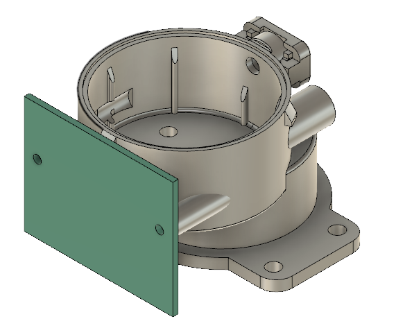

Project: LPG Monitoring Unit
We are working on a project that requires detection of the welded metal part on an LPG gas cylinder — specifically the portion used to support the RIM for holding.
For this purpose, we are planning to use the LDC1312 Inductance-to-Digital Converter IC. The required sensing distance is approximately 20 mm.
Could you please guide us on the feasibility of using the LDC1312 for this application, and share any relevant application notes or design considerations?
Looking forward to your support.
Please refer below image where PCB will fit & inductance (circular track) will generated on front side of PCB. Enclosure material is PC. In enclosure DC motor will be fit which is back side of PCB. We plan to make inductance on front side of PCB. Sensing distance is 20mm. We have below queries.
1. Does the motor will make impact on inductance ?
2. Does it sense MS from 20mm with 20mm Diameter of sensing inductance ?
3. Can we make inductance on single side (front side of PCB) ?

  • Hello Dattatray,
    Please see my comments below.
    The motor could have some impact on the inductance depending on the spacing from the coil.  This would need to be tested in your system.  Shielding of the coil may be able to help mitigate some of the effects.  See the app note below.
    Typically, the achievable range is about half the diameter of the coil.  To reach 20mm, you would need a coil diameter of around 40mm.  See the app note below regarding sensor design.
    Yes, the coil can be implemented on a single layer PCB.

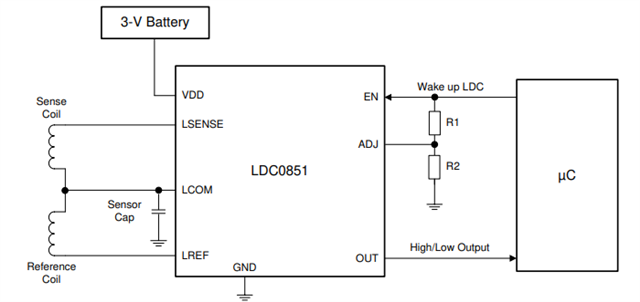

  • Our PCB size is changed to 26x33mm. We want to use LDC0851 to sense the MS metal. Sensing distance is 10mm. We want to use double sided PCB. We can make coil of 25mm diameter. Please refer below application circuit
    How to connect Sense coil end point & Ref. coil start point to LCOM ?
    How we can make the coil for double sided PCB ?
    If you have PCB layout in fusion, please share.
    Please guide.
    Dattatray
  • Dattatray,
    If you have 25mm diameter available, I would recommend using a stacked coil design for LDC0851.  See the app note below regarding this type of design.  I don't believe we have any PCB examples with a 2 layer PCB.  I would suggest looking at the LDC0851EVM as a reference which uses 4 layers.
