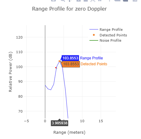

In an isolated room (anechoic chamber), I measured an 18 dBsm corner reflector and observed:
  • In the TI GUI (standalone setup): Relative power = ~104 dB
  • In the D3 package via CAN bus (side‑info TLV):

What exactly is the "Relative Power (dB)" shown in the TI GUI?
How can I derive it from raw TLV data or side-info fields?

    Q2:
    I believe the relative power is the amplitude of the range profile of the zero-doppler(or the range profile for static objects in the scene).  It should be the
    MMWDEMO_OUTPUT_MSG_RANGE_PROFILE
     TLV in the demo code(TLV 2).
