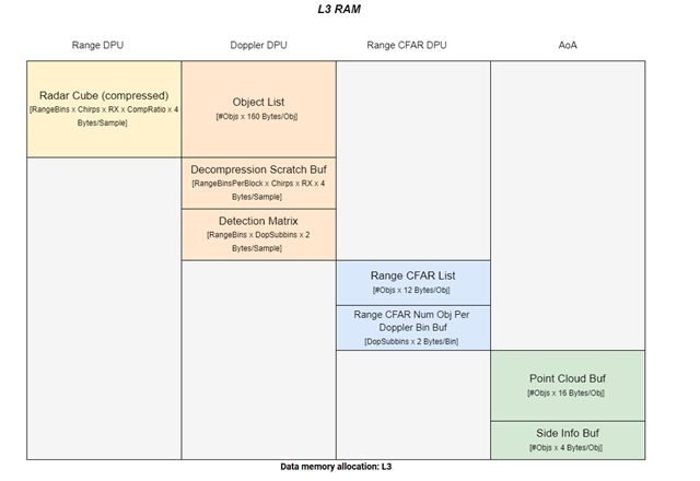

    By default is the full "doppler radar cube" accessible in a non-compressed format available in the L3 after it gets decompressed by doppler processing?
    No, if 8 range bins are compressed together, then those 8 range bins data is decompressed together.

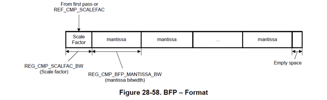

    Assuming that it will fit into the L3, won't the data still be in the compressed format (, i.e. EGC or BFP)? If they are then to my understanding, I still won't be able to read them as raw cmplx16ReIm_t data, is this correct? This is because they will be stored as shown in the image, the difference being that the compression will be of a factor 1, which will make it lossless, but still not directly interpretable as the raw cmplx16ReIm_t.

    Yes, you can access decompressed radar cube during doppler processing. It's not possible to access whole decompressed radar cube as the decompression scratch buffer is overwritten.
    In the current processing chain, disabling of compression is not supported. You can make changes in the processing chain to disable compression.
    Yes, you are correct. You won't get the decompressed radar cube.

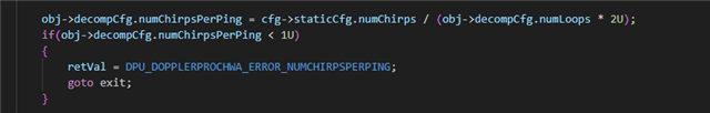

    This error can be traced to
    * File mmwave_error.h -> DPU base error -30000
    * File dp_error.h -> DOPPLER DDMA BASE -700
    * File dopplerprochwaDDMA.h -> DPU_DOPPLERPROCHWA_ERROR_NUMCHIRPSPERPING -12
    However this is clearly not the root cause as commenting out the single described modification of the struct DPU_DopplerProcHWA_HW_Resources results in the code running normal again.

    Place a breakpoint in CCS at the line where this error occurs. Check if there is any change in the value of any of the variables before and after addition of the additional member in the structure. Since this is a custom change, it's not possible to check this at my end.

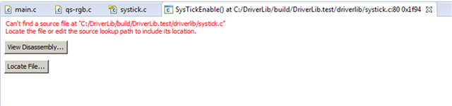

    Could you please provide some guidance on setting a breakpoint inside the file dopplerprochwaDDMA.c please? This file is not within the CCS project and it is not being compiled during build only during the linker's operation the pre-compiled binary is pulled in from this location:  "C:\ti\mmwave_mcuplus_sdk_04_07_00_01\mmwave_mcuplus_sdk_04_07_00_01\ti\datapath\dpu\dopplerprocDDMA\lib\libdopplerproc_hwa_ddma_awr2944.ae66"

    I think you are seeing something like the error shown in the below screenshot -
    Use Locate File… button to browse to the location of the source file. The debugger can then find other source files in the same location or use relative path information to find files relative to the current file. Location is remembered for future loads of the same program.

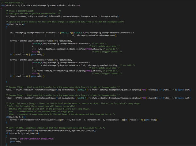

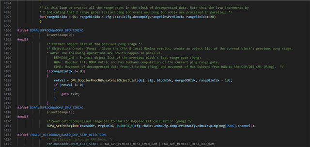

    You probably mean this loop? Where after the semaphore check the data from a single block will be present in the  L3 scratch.
    I meant in the loop which processes each range gate ->
    You can still add the transfer of data after the semaphore that you are referring to. But in that case, you need to calculate the offset at which the required range gate starts from.
    I don't see any error as of now, during build my CCS project's linker pulls in a prebuilt .ae66 file located here:
    • C:\ti\mmwave_mcuplus_sdk_04_07_00_01\mmwave_mcuplus_sdk_04_07_00_01\ti\datapath\dpu\dopplerprocDDMA\lib\libdopplerproc_hwa_ddma_awr2944.ae66
    I can rebuild this .ae66 file by running setenv and then gamke all in the dopplerprocDDMA directory. So that's why I wonder how can I set a breakpoint in this external library (,which I only pull in during linking operations)?

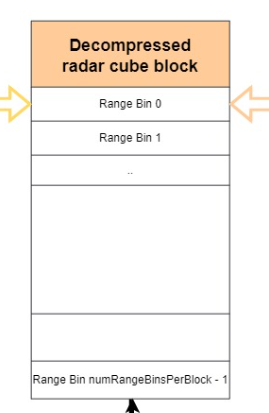

    That's a very good insight, thank you! One more question concerning this, what is the format of the decompressed outer block which we access here? From what I was able to find it is [numChirps][rangeBinsPerBlock (indexed via rangeBinIdx)][rxAntennas]  is this correct?
    Below is the screenshot of the format of decompressed scratch buffer  -
    Each Range gate includes all the chirps (chirp 0 - Rx0, chirp 0 - Rx1, chirp 0 - Rx2, chirp 0 - Rx3, chirp 1 - Rx0, chirp 1 - Rx1, ...).
