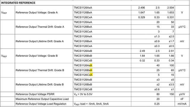

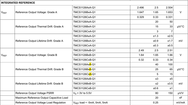

Page 10 of the TMCS1126-Q1 datasheet describes the Reference Output Thermal Drift: Grade B. But are the part numbers indicated as test conditions correct? These do not conform to the Device Nomenclature (page 35) and are inconsistent with the information provided in "Reference Output Voltage: Grade B" and "Reference Output Lifetime Drift: Grade B" sections.
TMCS1126 as well
