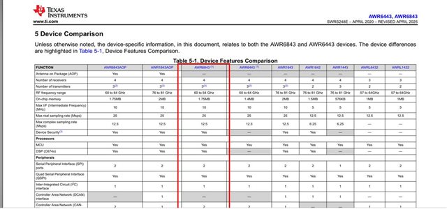

Whether AWR6843AQGABLRQ1 can spread out RF (Radio Frequency) signal itself, because I noticed in the data sheet that it is no ANTENNA on Package (AOP).
This is a question from the NBTC office, the government agency in Thailand. It is very important to know if this part requires an NBTC license when importing it into Thailand.
TICSC
I apologize for the delay in response. AWR6843AoP device has antenna on package which is capable of performing radiated emission. AWR6843 (non AoP) device perform conducted emission through PCB trace and radiate out through on-PCB antenna. Whatever your query is not related to AoP or non AoP device.
xWR6843 devices are compliant to emission regulatory standards.
