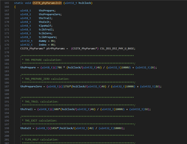

    I think CSI stream sending out from awr2544 is pixel mode compatible, however I have an issue that the CSI receiver is unable to decode a valid CSi-2 clock from awr2544 CSI-TX.
    Would you please let me know where in CSI-TX driver to adjust PHY timing and DDR clock timing?
    Thanks and appreciate your help!
    Quoc Lam

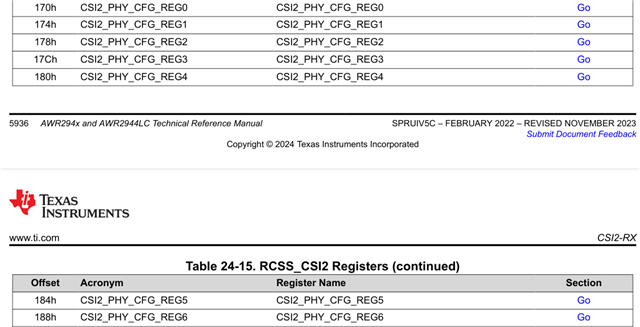

  • Hello Lam,
    You can refer the registers:
    and it happens in the code:

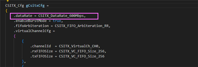

    The clk is the hsiClock which we set in the application:
    This selection of clock value is based on what the Per_PLL is configured to for example:
    if its 1200 Mhz, then the Data rate is 600 Mbps
    Is its 900 Mhz, Data rate is 450 Mbps.
    So its clock/2 to give you the data rate value which needs to be configured.
